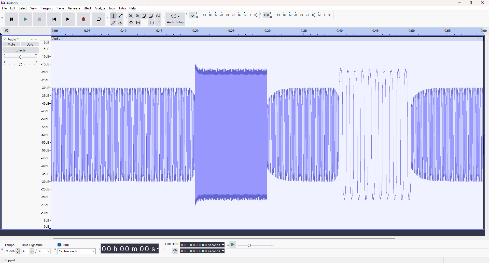

For the examples here, a 1kHz, -30dB tone of 600ms was used, mixed with:
- a click at 100ms
- a 5kHz tone burst at 200ms lasting 100ms
- a 100Hz tone burst at 400ms lasting 100ms
all peaking at -10dB.
Using Audacity's compressor, starting with all smoothing set to zero, a threshold of -20dB and a ratio close to infinity:
Then tweak only the smoothing parameters, leaving the compression curve parameters unchanged.

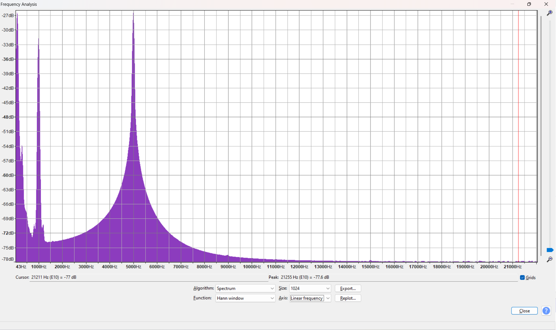

Spectrum

Bypassed
N/A
Three large peaks for each of the 1kHz, 5kHz and 100Hz tones is visible. (100Hz tone is on the very left.)
