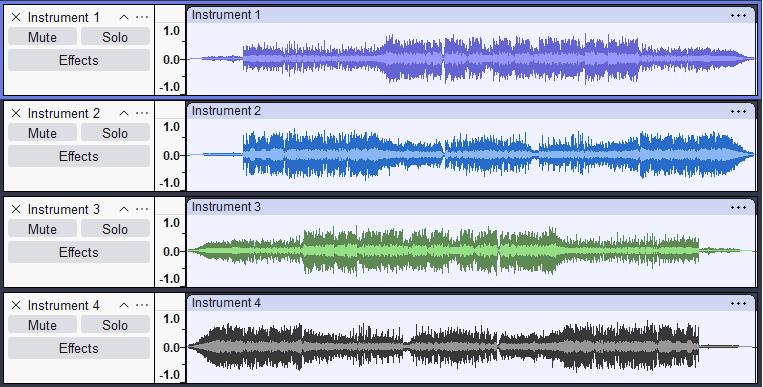

Wave Color
Selects from one of four colorways to be used for the waveform in the track.
