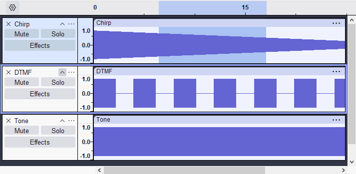

Now click the left mouse button anywhere inside of an audio track, and click and drag to the other edge of your selection, and release.
Because the drag started in the second track (as indicated by the colored focus border (the actual color depends on the Theme you choose)) and extended up into the first track, only those two tracks are selected, as indicated by the blue color of the Track Control Panel. Therefore, any operation you perform will now only affect the selected area of the first two tracks.
This, and the method for selecting all audio are enough for using selections in Audacity.
Visual cues indicating selection
There are two visual cues in tracks to alert you to the fact that you have selections present in those tracks:
  1. In the above image the selected areas of the two top tracks track where audio waveform is present have their background turned white and areas where no audio waveform is present have their background turned blue where the selection exists.
  2. The Track Control Panel changes from white to blue when a selection is present anywhere in the track. This can be useful as the selected audio waveform may not be showing on the screen.
In contrast the third track which has no selection present has its Track Control Panel background colored white.
These color variations vary when you use different Themes but they always show a clear contrast.

Focus versus selection
You will have read the term focus several times on this page and you may be wondering what is the difference between "focus" and "Selection".
You may have noticed in the images on this page that some of the tracks have a colored border around them (the actual color depends on the Theme you choose). This border indicates that this track has focus.
The track that has focus is the track that accepts any command whose name includes "focused track". These commands include commands such as "Close focused track" (Shift + C), "Mute/Unmute focused track" (Shift + U) and "Toggle focused track" (RETURN or Enter, which toggles whether the focused track is selected or not).
Advice A track having focus does not necessarily mean that the current selection is in that track. It is quite possible to have a selection in one track and for another track to have the focus.
In the above image observe that while the selection in in the Chirp track, the focus is on the DTMF track.
In the default Light theme the focus border can be hard to discern as it is a light blue similar to other colors used in Light theme.
